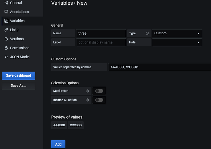

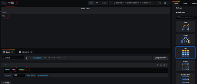

I am adding variable three with two names: AAABBB and CCCDDD
and put in query and get first three characters, filter shows AAABBB but table only three first characters AAA
In my query when I use it, it does not select the column and list the values. But, it just prints
SELECT UNIX_TIMESTAMP(time) AS “time”, LEFT(’$three’, 3) AS NAME FROM namedb ORDER by time ASC

maybe change visualization type
