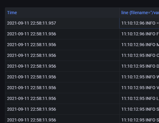

I didn’t include it on porpuse because of the format in the log that use two decimals instead of three. Nevertheless, I tried without changing the reg expression and I’m receiving no labels:
Sorry for my dumb question but did you set the proper time range in Grafana to look back? Also, whati sthe output of promtail’s server /metrics? What’s the value for promtail_sent_entries_total?
My bad! I tried again setting the time range for the last 7 days and now I can see data. Despite that, I still can’t browse all the labels I configured:

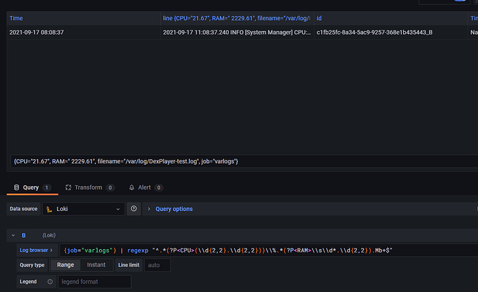

Hey! Turns out that the problem was the lack of date data so a entered (for now) manually in the log and now I can pass the time Label with no problems!!
Now, I have a next problem: Graph CPU asuge over time. I managed to reach this query:
But how can use the time/CPU data to graph it?
Nice! That’s what I was hoping in my last comment :slight_smile:
If I’m not mistaken you need to unwrap the label:
{job="varlogs"} | regex "^.(?P<CPU>(...))" | unwrap CPU
Maybe put a rate around it
rate({job="varlogs"} | regex "^.(?P<CPU>(...))" | unwrap CPU [10m])
Checkout the docs on Metric Queries for more details.
