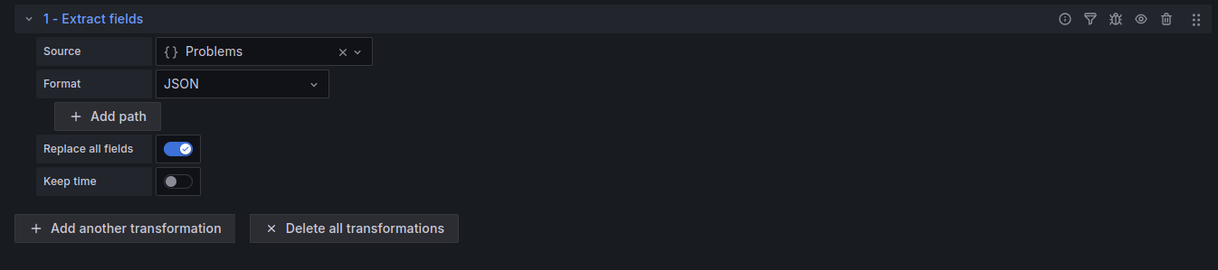

I know it’s an old post but if someone else is looking for this,
I did this using a transformation of type “Extract fields”
