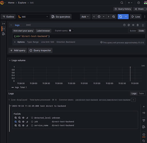

Thanks, I did that too - it returned a 204 and i see the entry but shows nothing in metadata in loki, so it seems its loki side (tried structured_metadata as well as structuredMetadata)

Also, can you share a screenshot from Grafana on what your test log looks like?

Here’s what the fake log looks like in grafana
