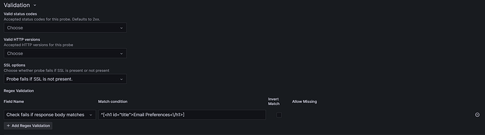

You can do this under validation → select Regex Validation → Check fails if response body matches, then put your regex in.

While the regex validation option appears to do something in the right direction of what i’m looking for, i’m not getting the result I need.
For example when I enter Login as the regex string, which is a string I expect to find if the correct page is loaded, the checks will fail if the string is found, where I would want the check to succeed if the string is found and fail otherwise.
I’m currently testing how the “Invert match” option works for this.
.+(?:Login).+
Use that above regex, and use the Invert Match. This will mean that the check will fail if login is not found. Make sure to also select the body to search and not the headers.

Hi again Jacob,
I tried your suggestion and it initially appeared to work as I had hoped. However on closer inspection it seems I can enter any string in the regex and the check will pass regardless, even with a string of which i’m very sure that it can’t be found on the page.
I’m trying some other regex variations but with no succes so far.
