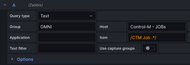

I’m trying to display the status of several monitored Jobs using the Stat panel.
To do this, I have created a query that can return various job-related data.
job_query
The idea is to use the same query for multiple panels, where only the fields displayed would change.

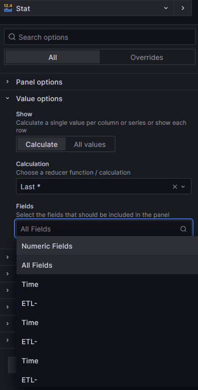

In “Value options” I can “select the fields that should be included in the panel”.
Selecting All Fields or Numeric Fields are somewhat limited options.
So, I found out that a limited Regular Expression can also be used in cases where there are many fields. BTW, I could not find this information in the documentation.
In my example, I was able to use the expression /Status - ETL.*/ to display only the field names for this first panel.
stat_fields_regex(1)
Now, my hope is to extend the expression to filter the fields without displaying the “Status” term.
I wish it was something like this:
/Status - (ETL.*)/$1/
But of course, this does not work out. It seems that the field does not support capture groups.
Any thoughts on this matter?
