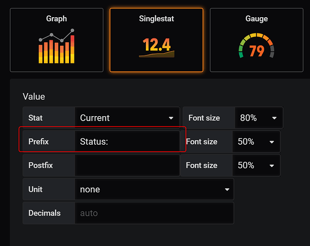

Just use your first query and set a Prefix in the singlestat panel.
mgrimm, thanks for your reply. As I wrote in my other topic, singlestat does not show the options in your picture. I assume we have different versions.
Anyway, your reply indicates that only static pre/postfixes are possible.
