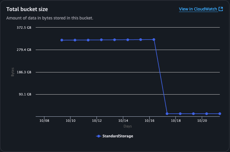

  2. After the deletion delay has passed, verify that the number of S3 objects and total size decreases.
    In the example above, applying a retention policy to a Loki setup that previously had no retention significantly reduced the bucket size.
