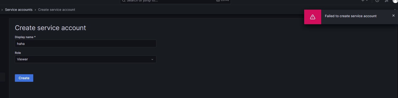

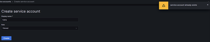

I have recently upgraded my Grafana OSS stack to 9.5.1 and now I’m having issues with service account creation, when trying to create new service accounts via the UI. Most of the time, I get an error message saying “Failed to create service account” (screenshot 1). When I then try to create a new service account with the same name, I get a message saying “service account already exists” (screenshot 2). The service account is not visible in the Grafana UI.

when I try to create again i get the “service account already exist” error with below log.
msg=“Request Completed” method=POST path=/api/serviceaccounts/ status=500
