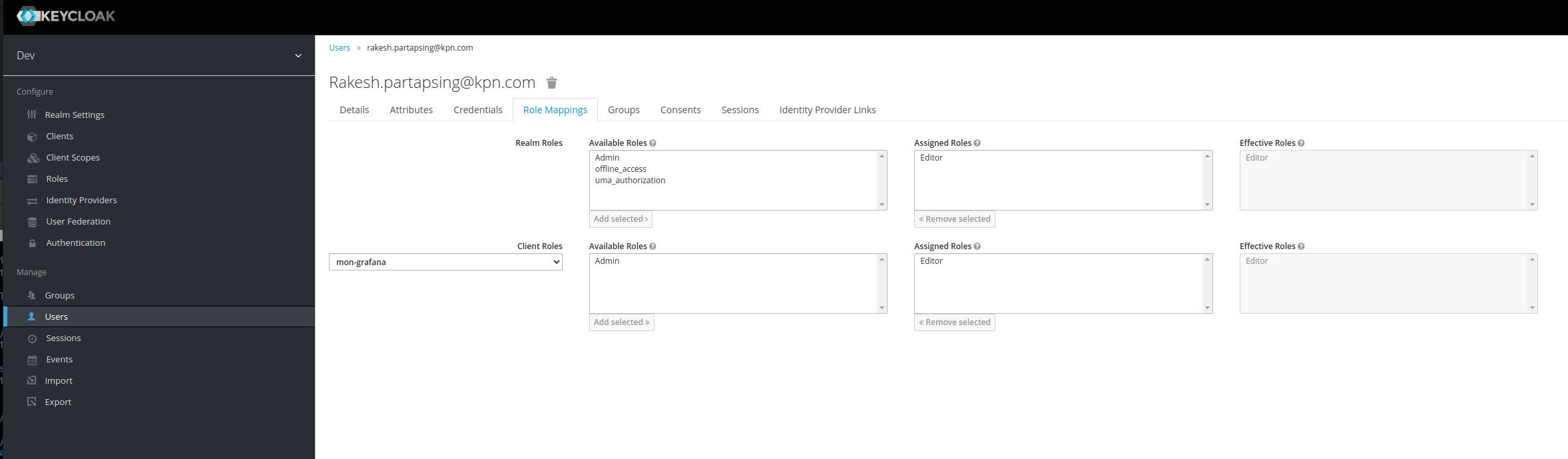

    Enable the Editor or Admin role via keycloak.
    Creating a client, role and mapper in keycloak
    Creating a user and assigning the role to the user

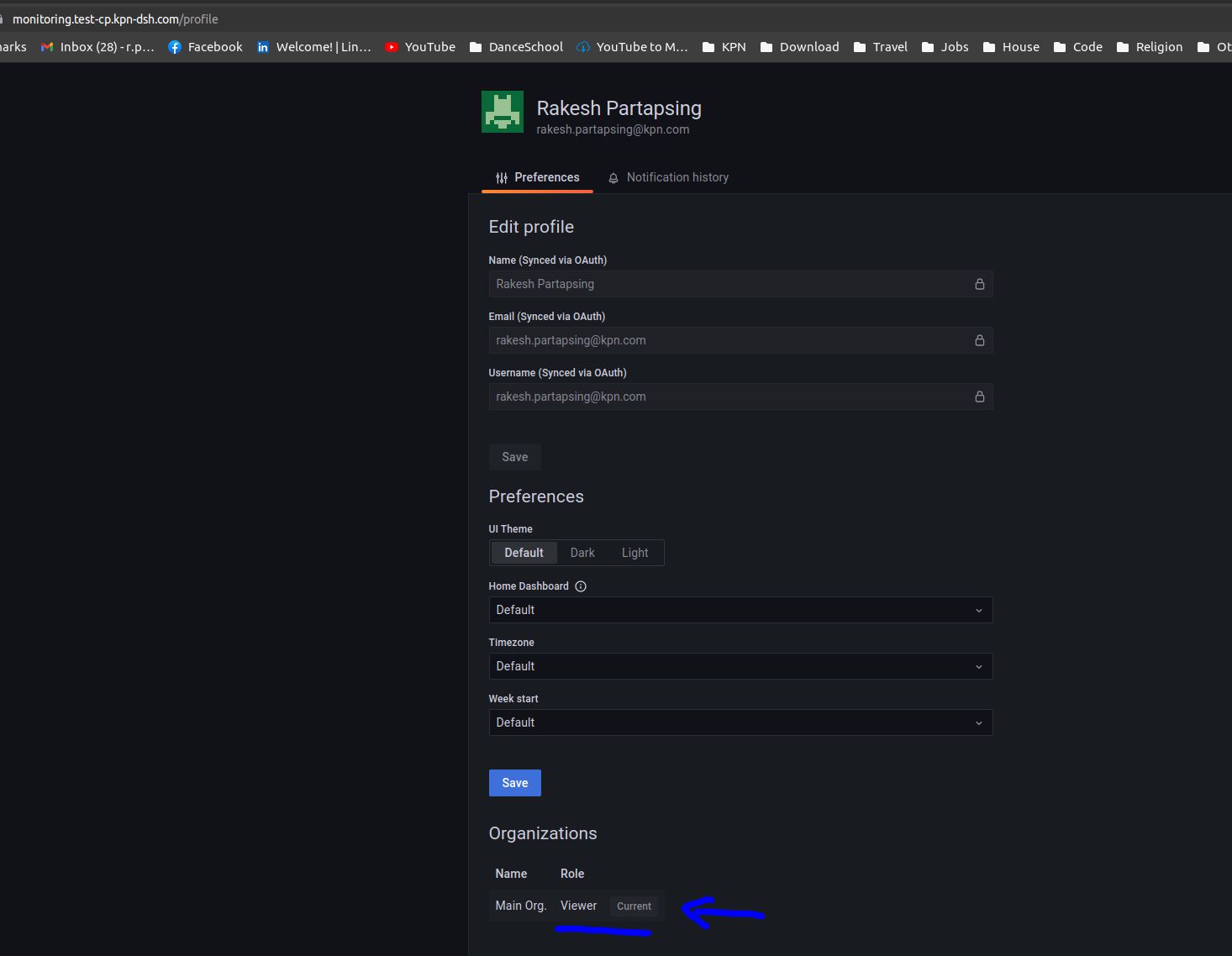

  • What happened?
    My role is still the default: Viewer

    I should have obtained the role of Editor

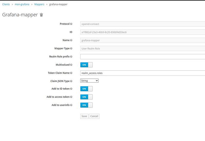

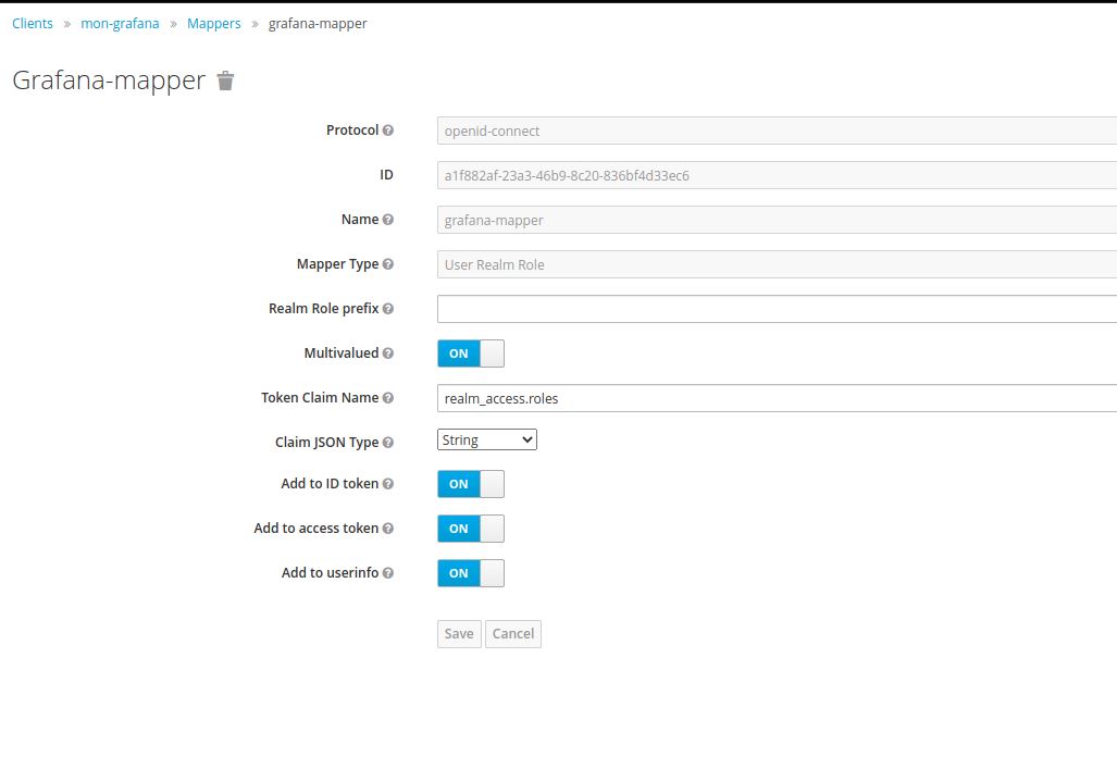

And indeed the mapper was not correct.
By creating the mapper as such:
and
role_attribute_path: "contains(realm_access.roles[*], 'Admin') && 'Admin' || contains(realm_access.roles[*], 'Editor') && 'Editor' || 'Editor'"
it was fixed
