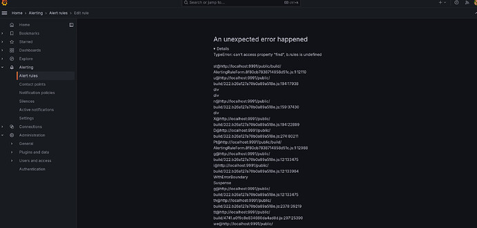

After successfully uploading an alert rule. I get the error in my alert rule detail :
[sse.dataQueryError] failed to execute query [B]: invalid: failed to decode request body: request body requires either query or AST
when I try to edit the rule :
