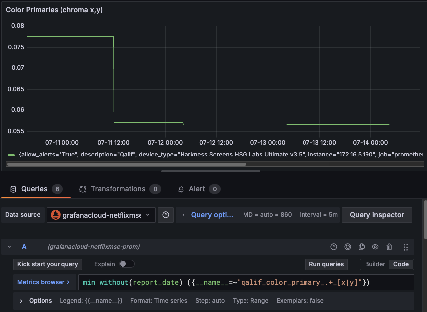

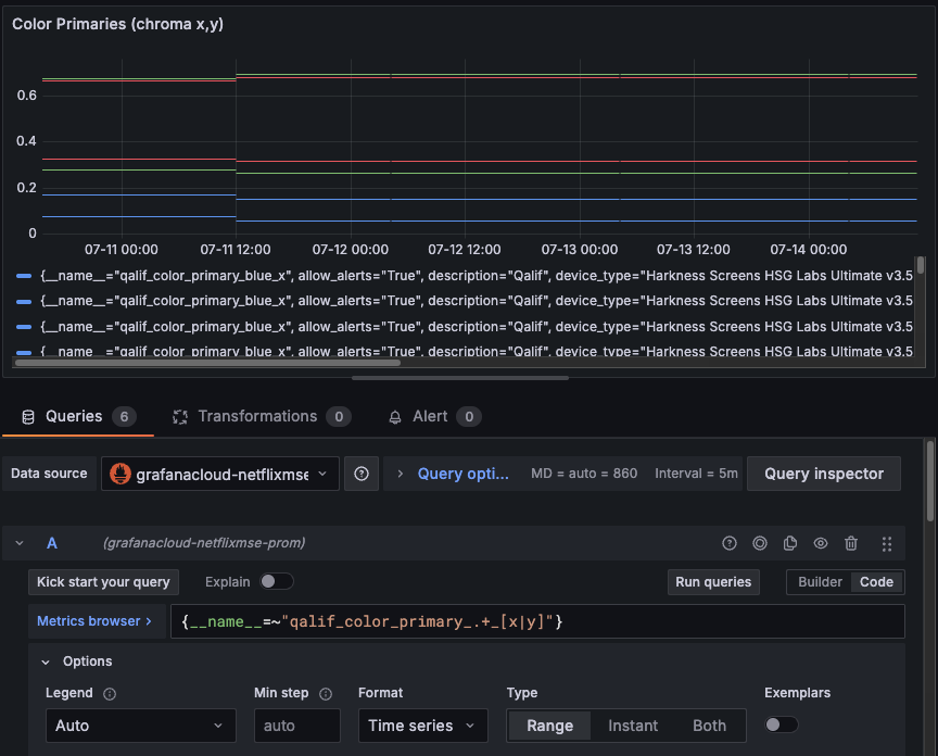

I have 6 Prometheus series with a label called report_date which changes every day. So on a time series graph, each day looks like a separate series. (In this screenshot, I’m looking at 5 days so there are 30 series.) I want to ignore that label so the graph shows 6 lines instead. I tried min without(report_date) ({__name__=~"qalif_color_primary_.+_[x|y]"}). The regex works, and report_date is removed, but it also removes the __name__ label. Why?
This is a problem because I’m trying to use {{__name__}} as the legend.

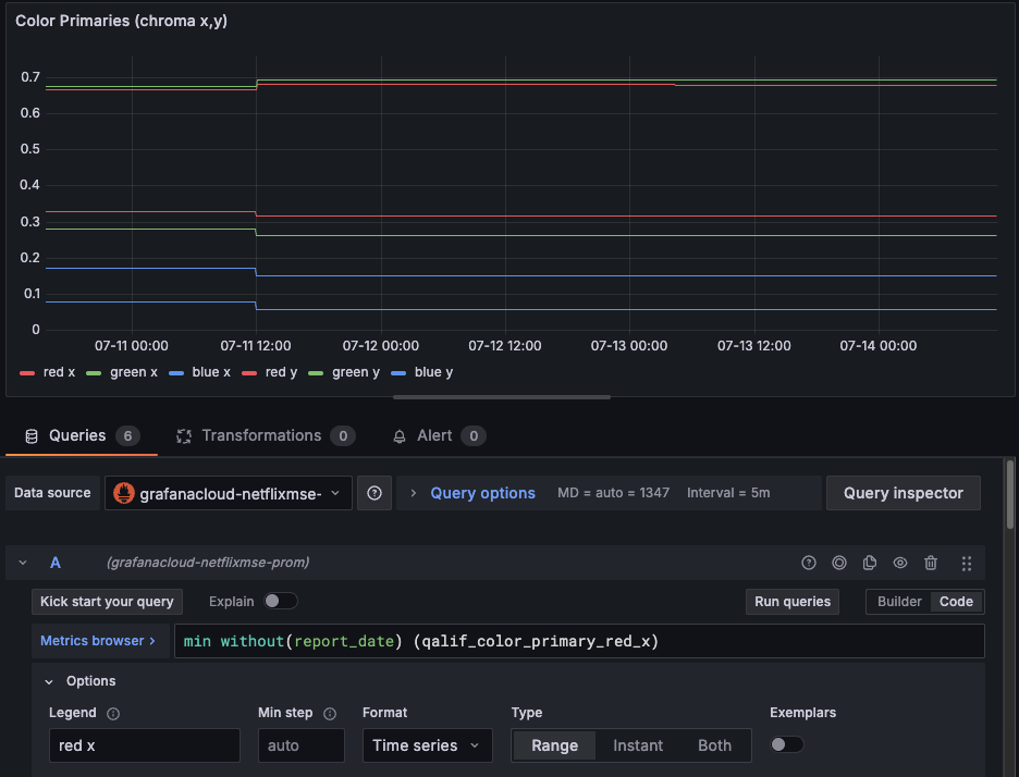

As a workaround, I can make 6 separate queries and set the legend manually. But this requires more effort and I’m curious why the above option doesn’t work.
