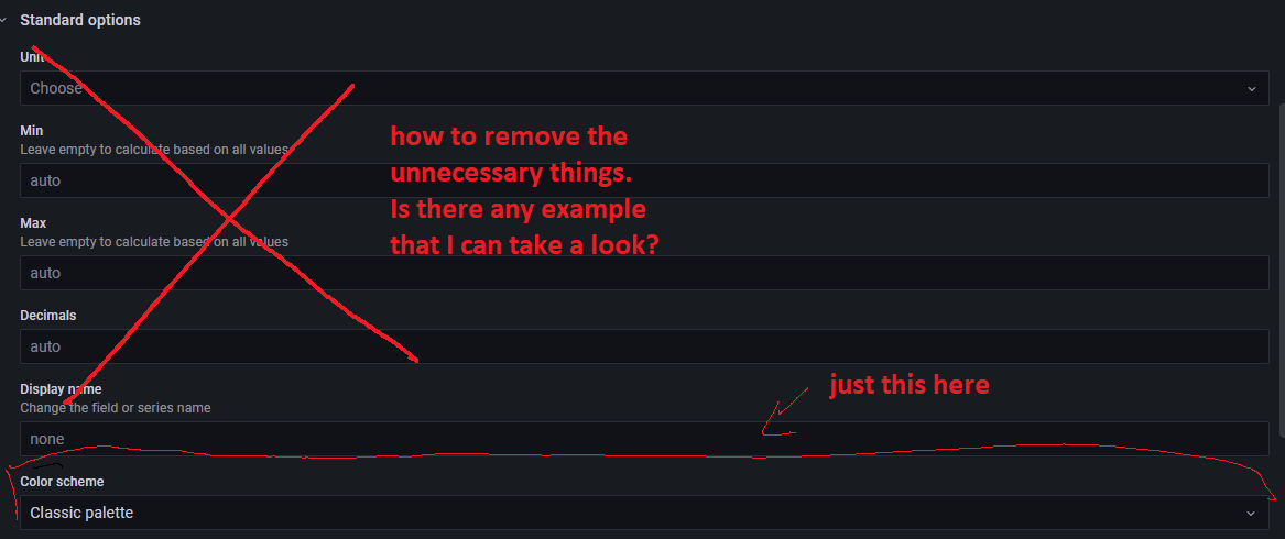

I am developing a panel plugin that should have a color scheme where we select a palette.
However, how to add this in my module.ts without all the standard options.
The foto below show the color palette with all standard options. This I could integrate. However, how to integrate just this in my panel plugin!
Thank you very much in advance!

I’m pretty sure I’ve been able to do this in previous versions:
module.ts
  .useFieldConfig({
    standardOptions: {
      [FieldConfigProperty.Color]: {},
… but in the latest version it seems I instead have to remove the ones I don’t want:
module.ts
  .useFieldConfig({
    disableStandardOptions: [
      FieldConfigProperty.Decimals,
      FieldConfigProperty.Unit,
      FieldConfigProperty.Min,
      FieldConfigProperty.Max,
      FieldConfigProperty.DisplayName,
      FieldConfigProperty.NoValue,
      FieldConfigProperty.Thresholds,
      FieldConfigProperty.Mappings,
      FieldConfigProperty.Links,
Let me know if any of them work for you!
Thank you very much! It worked right straightforward!
