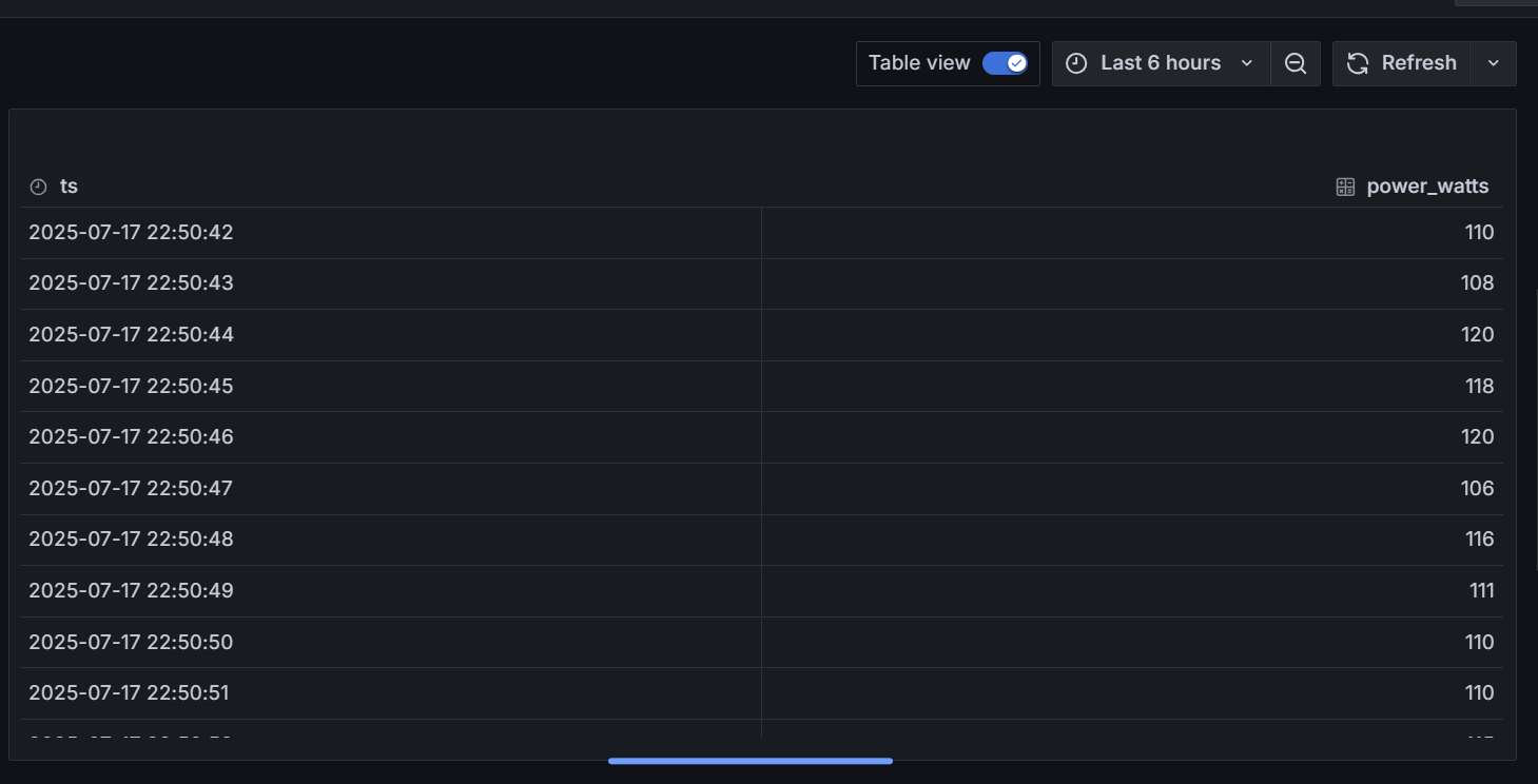

Step : 2 Insert Dummy Data

Final Result Look Like

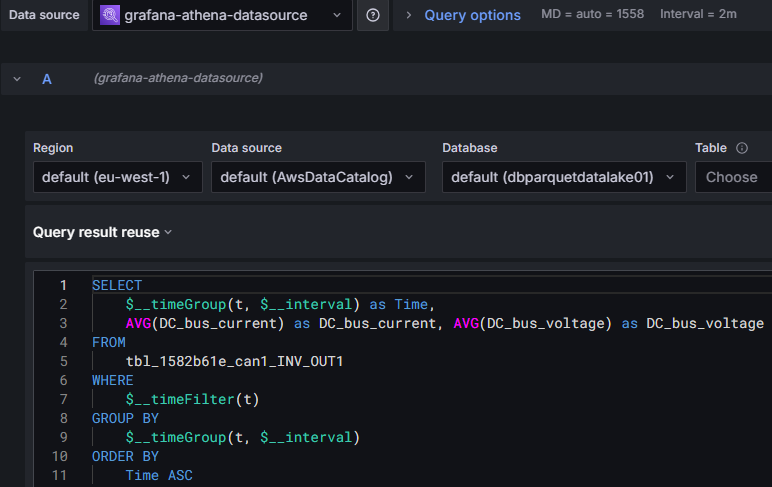

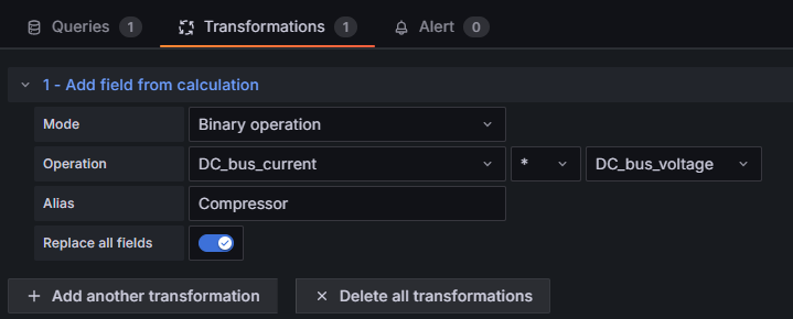

Hello @infofcc3
Please see the screenshots of my query. I use a transformation to calculate the actual power consumption by multiplication of current and voltage.
