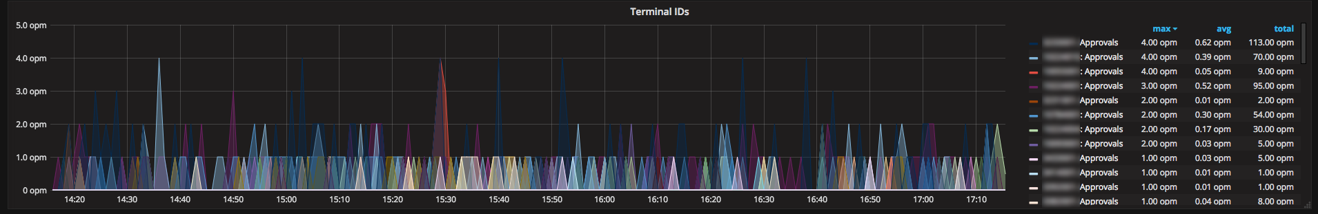

The root problem is that if I graph the last 15 mins of data it shows correctly, as it’s only trying to graph maybe 50 lines, but if I put it out to 3 hours there are then thousands of lines that it is trying to draw in theory. In practice is seems to give up after a set number, so the lines you’re actually interested in, the ones showing high values, are omitted completely from the graph.
An example: Below is the graph with one hour shown which shows me useful data:
but this is the same graph just changes to 3 hours:
As you can see the useful information is omitted and this implies that there’s no load on the system.

Can you share the query you’re using? It would also be helpful if you could take the same screenshots but first click on the name of the series that shows high usage on the 1-hour graph so that only that one is shown for both time-scales.

The one that shows high on the 1 hour graph doesn’t show at all on the 3 hour graph, that’s the main problem! I think it’s because its just drawing the first 55 lines and then crapping out, and it hasn’t got to that value yet.
I effectively need it to show the top 55 by value, not the first 55 in whatever order it finds them.
