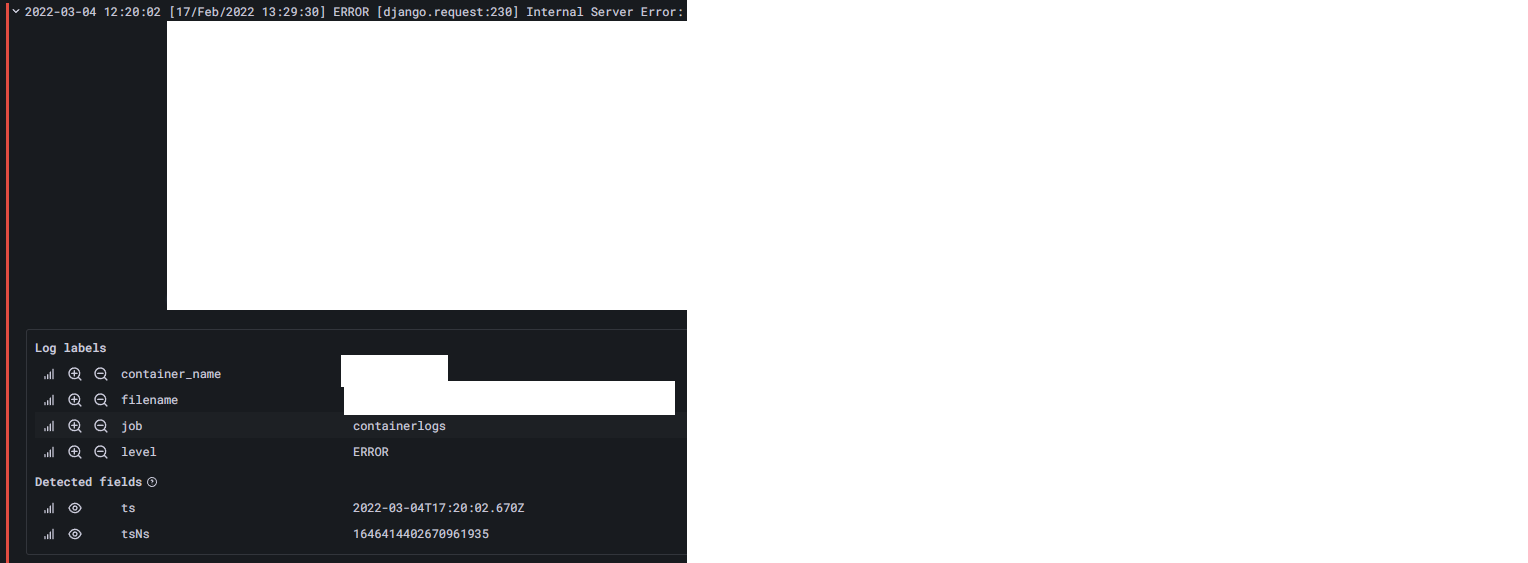

Need assistance recognizing timestamp from logs
The format is the following [02/Mar/2022 13:42:53] ERROR [django.request:230]
The log style is multiline
Logs messages are being inserted with timestamp at creation
The reason why you see the log date and the promtail date is different, is because I ingested a log with older entries as a target with promtail

2022-03-04T20:28:04.787766983+0000      {__path__="/var/log/containers/**/*log", job="containerlogs", level="ERROR"}    [02/Mar/2022 13:42:53] ERROR [django.request:230]

Update - it still doesn’t put the right timestamp into prometheus. The events are being inserted with the wrong timestamp still. I don’t understand why. Check out this dry run:

Timestamp is supposedly corrected, but I go search for the log entry for the date, and i dont see it. [Not from this dry run, specifically’]
