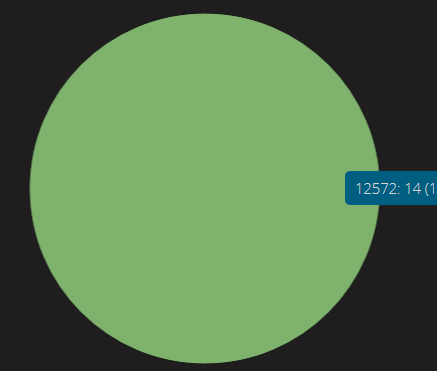

Hi,
Example with a pie graph.
i have two query :
one query is “some information send before XX min”
second query is “some information send after XX min”
if in my two query i have information, it’s OK my graph appears
But if one query is empty :
data :
first query : 5 100%
second query : 0
my graph not appears and i have the message : “Found row with no time value”
I would like my graph appears everytime even if i have just one query with data (so pie chart 100%)

for a better understanding
