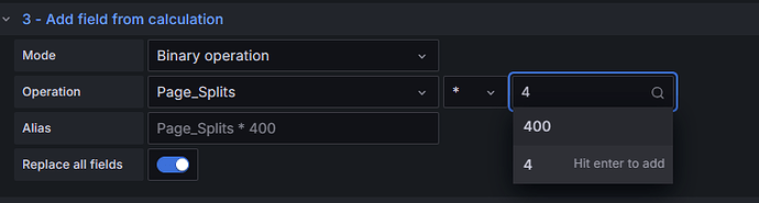

I tried using transformation, but could not multiply by an constant.
I tried expression Math → But dont know how to change just the values.

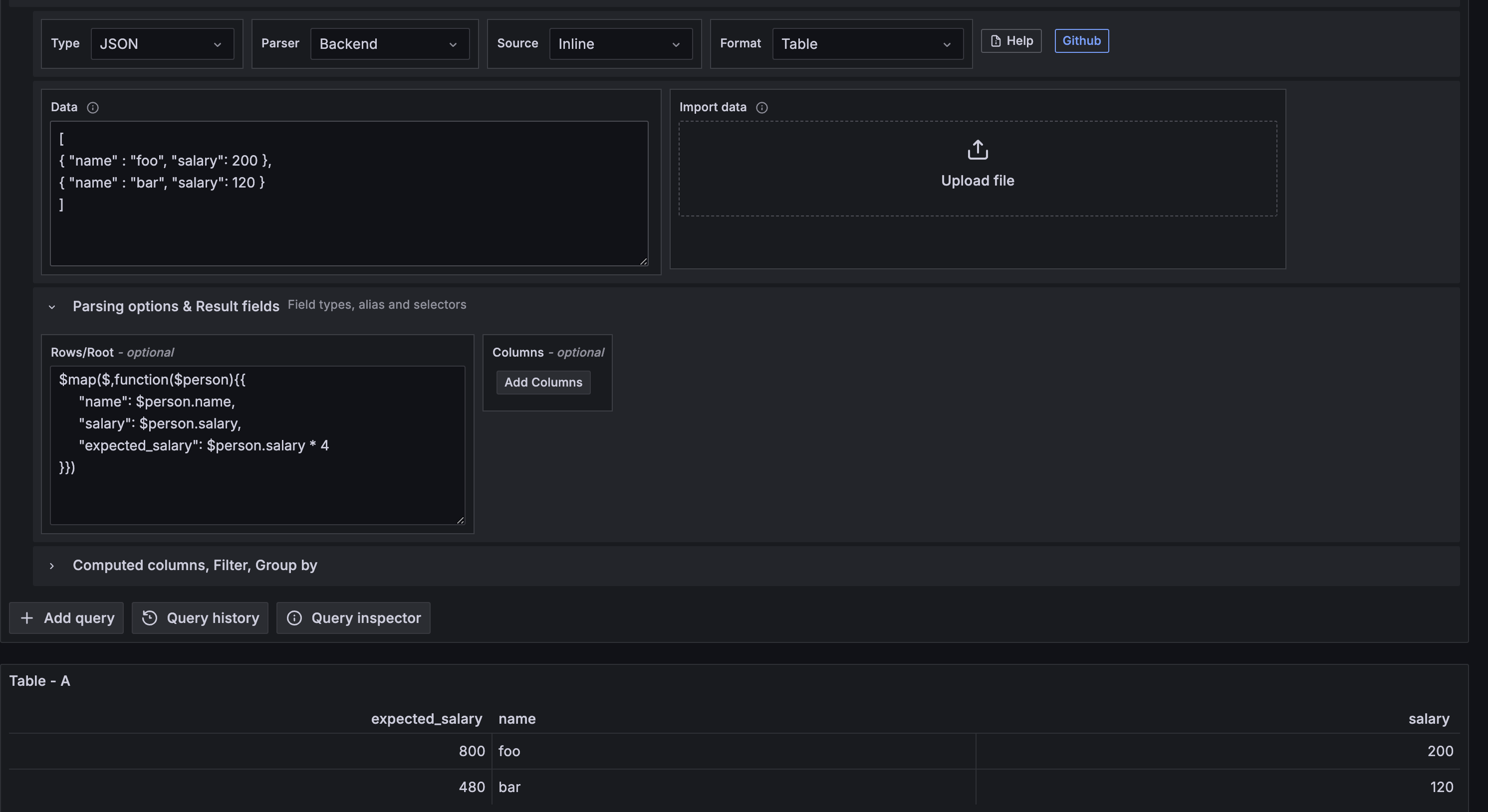

Yes As @sowdenraymond mentioned, you can use transformation. But if you prefer to do within infinity you can do this by one of the following methods. ( doing within infinity will help in other backend contexts such as alerting ). Example given here
