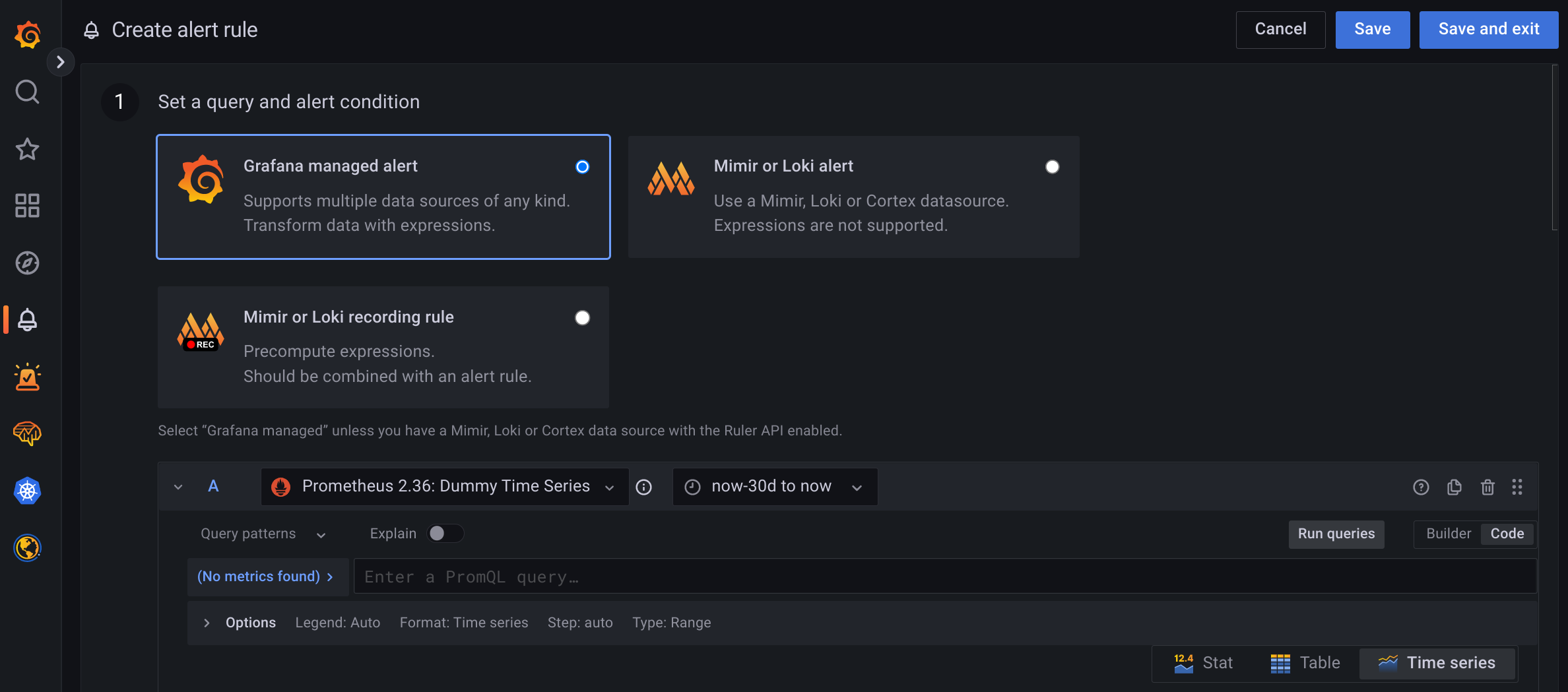

Can you create an Alert Rule with your Prometheus datasource as the source, and then post your query in the box and test it to see if it yields results?
Once that is working, you would go on to create a Reduce expression in B and then a Math expression in C, and then alert off of expression C.
But for now, let’s just focus on getting query A working.
Thanks, managed ![]()
