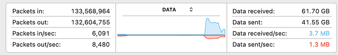

I have another round testing in office with better network bandwidth. The network is not the bottleneck.
CPU
Mem
Network
When VUs increased to about 3000, there will be errors. And network traffic is not high.
So ulimit n is ulimit -n 10240, system resource is not the limitation.(CPU, Mem, Network). Have no idea how to go forward.
Thanks,
