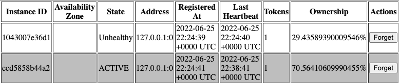

When I check distributor ring api:
On Loki1:
On Loki2:
  • Loki1 does not see Loki2.
  • Loki2 does see Loki1 but evaluate it as Unhealthy. Comparition of Ownership differ from time to time, last time It was 49 to 51 percent.
