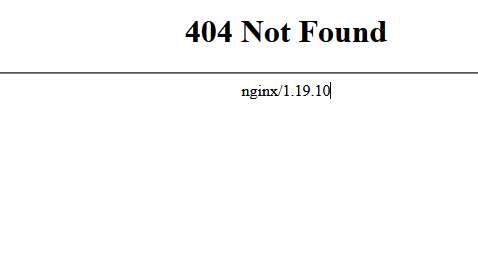

It seems that an nginx in the backgroud reacts when I call the domain with path /lokigateway but I geht en Error 404:
Does anyone in the Community has experience using loki with traefik as ingress controller?
