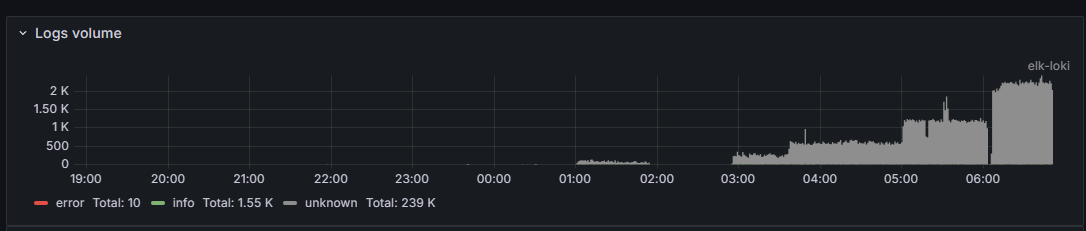

From this image, it can be clearly seen that old logs are gradually gone. This corresponds to the flush event on Loki log:
If I decrease max_chunk_age, the logs will be gone faster.
