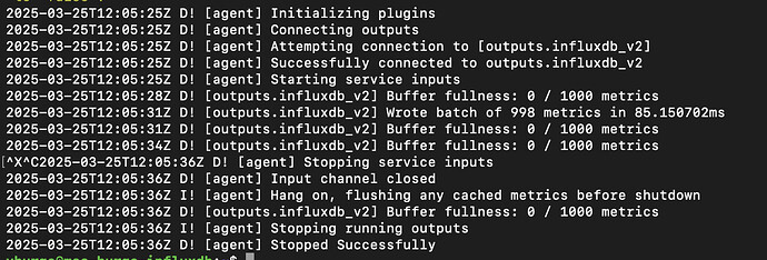

okay I checked the extra_column row which had NA and a string which had high cardinality. so I removed it as it was not important it was just empty. even after that the results are same it retrives 498 out of 998 rows inserted :smiling_face_with_tear:
Provide reproducible example what you doing, pls.
these are things I tried without NA columns which had string value.
and when I checked cardinality
