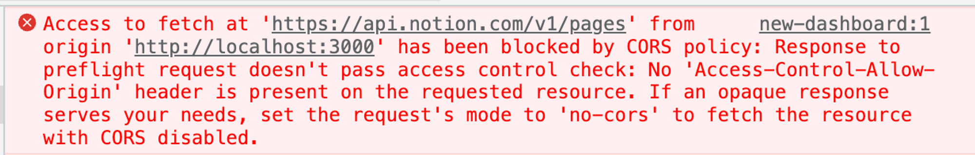

HI @yinjialu
First keep in mind you should not use dataSourceRequest since this is a deprecated method. You should use fetch instead.
e.g:
const response = getBackendSrv().fetch({ url: 'https://jsonplaceholder.typicode.com/todos/' });
const jsonData = await lastValueFrom(response); // import { lastValueFrom } from 'rxjs'
When you use getBackendSrv to fetch a non-preconfigured url in your datasource it’ll go through the browser as you are experiencing in this case.
To make this request go through the backend you must save this url in the datasource configuration form as url and then you can use instanceSettings.url in your datasource to make the request (instead of the hardcoded url as in your code here).
This is very important when you start working with authentication in your API to prevent leaking credentials in your browser request.
You can find a full working example of this here and more specifically in the datasource.ts file.
Additionally check our documentation on adding authentication to your plugins and read about proxy routes to understand better how all this works and how to store more than one URL.
