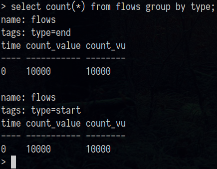

Hi there,
your approach seems fine to me, though I couldn’t reproduce your issue of different number of start and end metrics, and my tests had the same number of both:
2020-04-03-102515_435x339_scrot
This might mean that your iterations are being cut short for some reason, or that there are errors submitting the metrics to InfluxDB. Did you receive any errors in the test output? What command did you use to run it?
