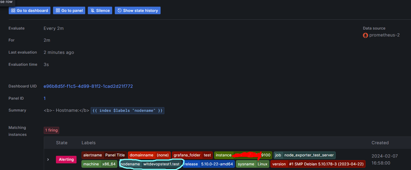

Here is a basic alert and labels:
labels for:
node_uname_info{nodename="wltdevopstest1.test"} query - Executed in separate alertrule.
I tried adding the query to alert above - zero reaction, Buuut
This works , only on it’s own :smiling_face_with_tear:
Your annotation looks good to me! {{ index $labels "nodename" }} would be correct.

Just to put {{ index $labels "nodename" }} in my working alertrule
And that’s what I got
Query for this rule:
So here I tried to combine two queries: query E - that gave me the chance to retrieve hostname in separate alertrule in the message above - don’t work in my main alertrule. You can notice Annotations - {{ index $labels "nodename" }} - here gives me nothing
I suspect there are two problems here: 1. Query E is not used in the execution graph that calculates the alert condition 2. Grafana does not know how to join the data from query A with the data from query E because there are no common labels between them.
I think you need to add the nodename label to your metrics in Query A.
