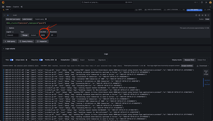

Hello, I want to configure grafana such that it prevents users from putting large number in the Line limit.
As you can see in the screenshot above, there is no such upper limit control in place and user can put any number in the box.
is there a configuration in grafana/grafana-ui to facilitate this behaviour?

as you mentioned this config belongs to loki and not grafana, now if I change the loki config is there a way for garafana to reflect this limit in its UI for I need to change it manually both in loki and grafana?
as you mentioned this config belongs to loki and not grafana , now if I change the loki config is there a way for garafana to reflect this limit in its UI
I don’t believe so, no. You’ll need to configure both to the same value.
