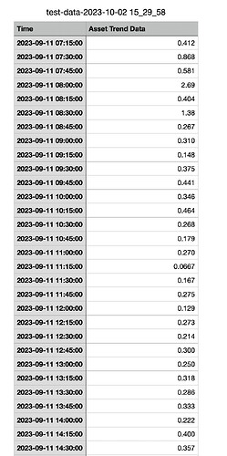

Certainly. My objective is to determine the 95th percentile. To achieve this, I plan to follow these steps: first, sort the data. Then, I’ll calculate the index of the 95th percentile using the formula: total number of records * 0.95 → Round(result). Once I have this index, I intend to retrieve the corresponding Trend data value for further analysis.
Not allowing me to attach any JSON. Sharing a screenshot.

cool, can you please post the data as inline json as follows
 "target": "Asset Trend Data",
"datapoints": [
   [ 237450.63, 16957098000000]
Also what do you mean by "total number of records * 0.95 " which total number of records is that? count of datapoints?
this will allow us to help you.
