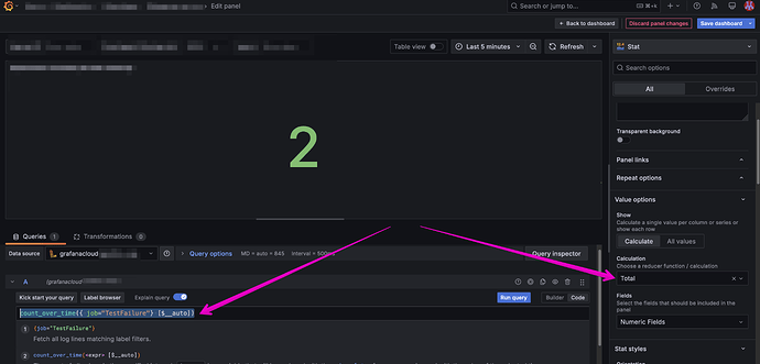

I’m a bit late to the party, but hopefully I can help someone else trying to have a number widget that displays the number of log lines in the period selected on the dashboard level.
If I misunderstood the initial conversation, sorry for that.
My solution is rather simple:
count_over_time({ job="TestFailure"} [$__auto])
The key was to use
[$__auto]
Also, you need to select Total in the chart config:
In the end the number is the total of log lines
