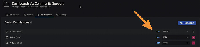

Have you considered using dashboard-level or folder-level permissions instead?:
https://grafana.com/docs/grafana/latest/permissions/dashboard-folder-permissions/
then you could provision two dashboards that are effectively the same, except for the locked-down admin dashboard, a variable’s query could be SELECT * FROM users, and then the public dashboard uses a query more like SELECT $user FROM users? You could then select viewing and editing privileges as needed?
