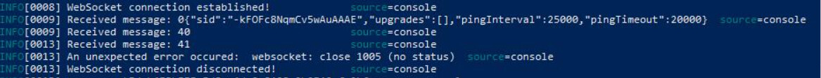

Connection gets disconnected and all the status messages are not received.
Requesting you to please help me with the same.
@Tom : Requesting you to please help me with the above query.
The code looks OK, but it’s hard to tell without seeing your whole script and what settings you’re using to run it.
A quick google suggests close 1005 corresponds to a CloseEvent, which appears to be a server-initiated request to close the connection. Anyone’s guess why it’s doing that, though… :slight_smile:

Based on your console output, you are able to see messages arrive; the first message has a sid among other things, but the 2nd and 3rd don’t seem to have anything except an identifier (40, 41). As we don’t know the server-side WebSocket implementation, we can’t tell you what those mean; for all we know, the client is meant to respond to those messages, and not doing so within a certain amount of time could cause the server to close the connection.

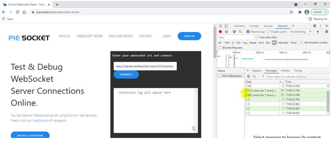

In the meanwhile I was just trying to test the socket code in k6 for below website:
  var url = 'wss://piesocket.helpcrunch.com/socket.io/?EIO=3&transport=websocket';
  var res = ws.connect(url, null, function (socket) {
    socket.on('open', function open() {
      console.log('connected');
      socket.setInterval(function timeout() {
        socket.ping();
        console.log('Pinging every 1sec (setInterval test)');
      }, 1000);
    // TM - and handle the response
    socket.on('message', function (message) {
      console.log("Received message: " + message);
    socket.on('ping', function () {
      console.log('PING!');
    socket.on('pong', function () {
      console.log('PONG!');
    socket.on('close', function () {
      console.log('disconnected');
    socket.setTimeout(function () {
      console.log('10 seconds passed, closing the socket');
      socket.close();
    }, 10000);
  check(res, { 'status is 101': (r) => r && r.status === 101 });
I am getting the below output :

But when I see the network socket in the website , I am getting few more messages like message 42 , but not getting in k6 script :
Requesting you to help me for the same.
hi @chkant,
From my very fast testing the 42 messages are outgoing from you to the server and at least I couldn’t reproduce them being sent with firefox or chromium without me typing them in the send bar.
Looking at your screenshot I don’t see another connection, so you don’t seem to be looking at the wrong one. On the other hand if you are connected to the websocket the pie socket site should have a field to send messages which you don’t :thinking: .
The 42 in front seems to be a socket.io thing and k6 does not support socket io and looking at this workaround the format is slightly different, but maybe it is a different socket io implementation :man_shrugging:
