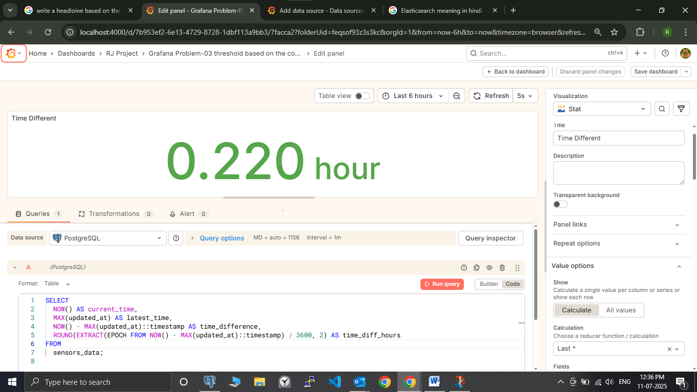

You can solve your problem using follow the below give steps.
Step : 1 Get last updated time form your respected datasoure
Step : 2 get Latest time using now ()
Step : 3 Calculate the difference between Current time and Last Updated time
Using following query
SELECT
  NOW() AS current_time,
  MAX(updated_at) AS latest_time,
  NOW() - MAX(updated_at) ::timestamp AS time_difference,
  ROUND(EXTRACT(EPOCH FROM NOW() - MAX(updated_at)::timestamp) / 3600, 2) AS time_diff_hours
FROM
  sensors_data;
Step : 4 Steup Visulization as a State
Calculation = Last*
Field = calculatd Time Difference (field Name)
Unit = hour
Add Theresold
0 green
1 red
24 other
  • Final Output
