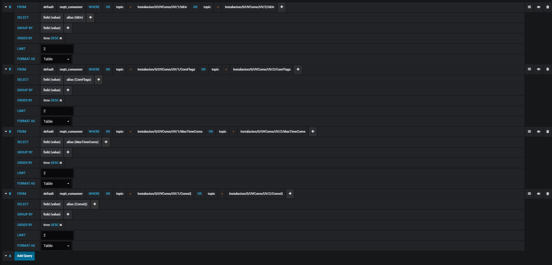

Good morning, I’m trying to make a table with timeseries data that is stored in influxdb. I’m using the grafana table panel. When my two returned values has the same timestamp my table is showed properly but when the two returned values has a diferent timestamp they are showed in diferent rows (they are in the same second but not in the same milisecond). I want to know how can I change my query to has values in the same row although they are not in the same timestamp (precision of seconds not miliseconds). I think that the solution is to change the epoch param or the precision param but I dont know how to do it. Can anyone help me?
Here is my table:
Here is my query:

It looks like this:
"SELECT “value” AS “IdUv” FROM “mqtt_consumer” WHERE (“topic” = ‘Instalacion/0/UVComs/UV/1/IdUv’ OR “topic” = ‘Instalacion/0/UVComs/UV/2/IdUv’) AND time >= now() - 6h GROUP BY time(1s) ORDER BY time DESC LIMIT 2;
