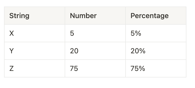

I have data something like
And I want to add another column which calculate percentage for “Number” column
Basically
PercentageX = (NumberX) / (NumberX + NumberY + NumberZ)
This seems so genuine and easy but I can’t find an option to do so

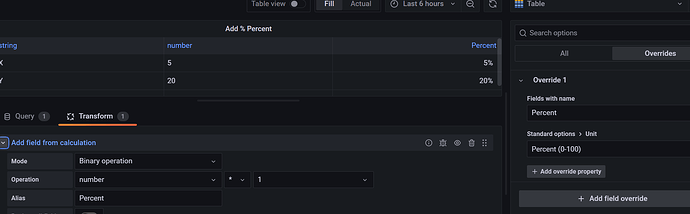

Hey @yosiasz how it is calculating percentage ? You have just added the unit right ?
as I mentioned in the post it has to calculate this formula
The numbers in the example that I have given adds upto 100 just to simply the things, but it will not always be the case
You give some more clarification if there are 2 rows with numbers 80, 120 then the percentage should be 40% and 60%
