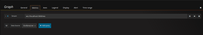

The idea is to push data in the form of this StreamMessage struct to this api call (that is commented out and wrong). This code here pushes the data to the websocket hub.
Then in the Graph panel in the Stream field (if everything worked) then it would show a list of streams. You would pick one and it would stream to the Graph panel.
