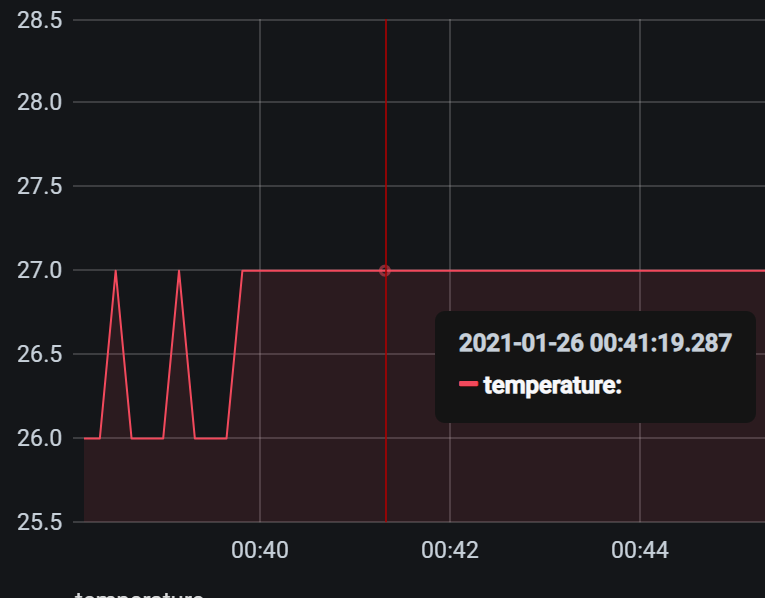

When I try to add a panel and select humidity or temperature I get an error
If I delete the
GROUP BY
time ($__interval)
fill (null)
which is the default I get the graph on the panel but the cursor do not show the values
I think I do the same as the guy in the video but I do not get the same results.
I was playing with a MySQL and had the same problem of not showing the values under cursor and I had to cast string to float.
In the video he pushes string to db though.
Any help is appreciated, thank you
