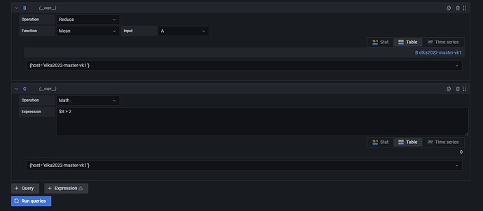

I am using Grafana 8.2.2 + InfluxDB.
Aleting to slack from Grafana.
Use multi-dimensional rule for notification.

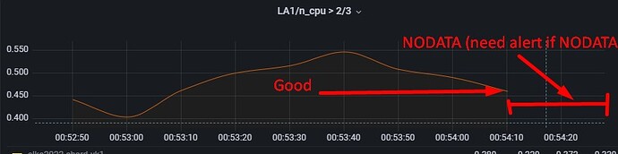

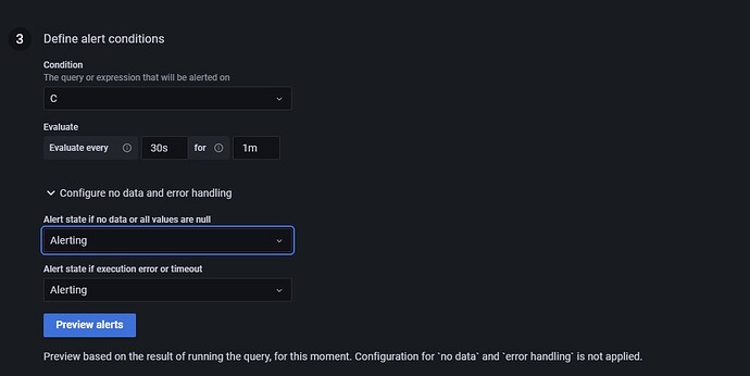

Need alert, if NO DATA.
In screenshot:
Rule:
also doesn’t work:

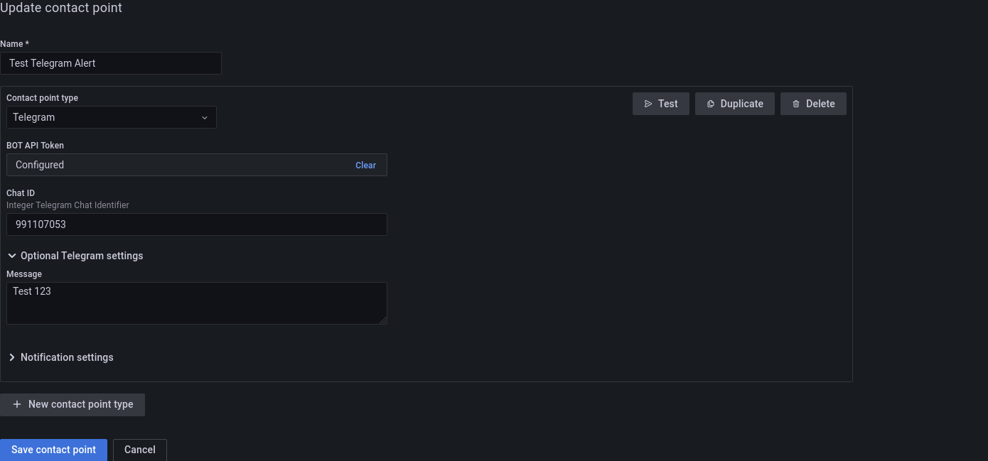

The problem can be “fixed” by setting a custom telegram message:
However, now only this message without any information about the alert itself is displayed.
