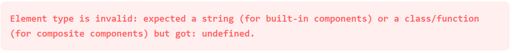

I have a plugin I developed for Grafana version 6.7.3 in React, and it works fine on that version. I’m trying to upgrade to version 7, and running into issues. Without changing anything, the same plugin that works in v6 is giving me an error:
When I dig into the console error, it’s a React minified error. When I click the link to decode the error, I get this page:
By systematically removing elements in my plugin until it works, I’ve determined that adding a element from the @grafana/ui import causes this error.

I have two questions:
- How can I build my plugin in React development mode so I can see more detailed errors?
- More importantly, how can I use the FormLabel (or other Grafana UI components) without this error? Do I need to update my libraries at all to move to v7?
