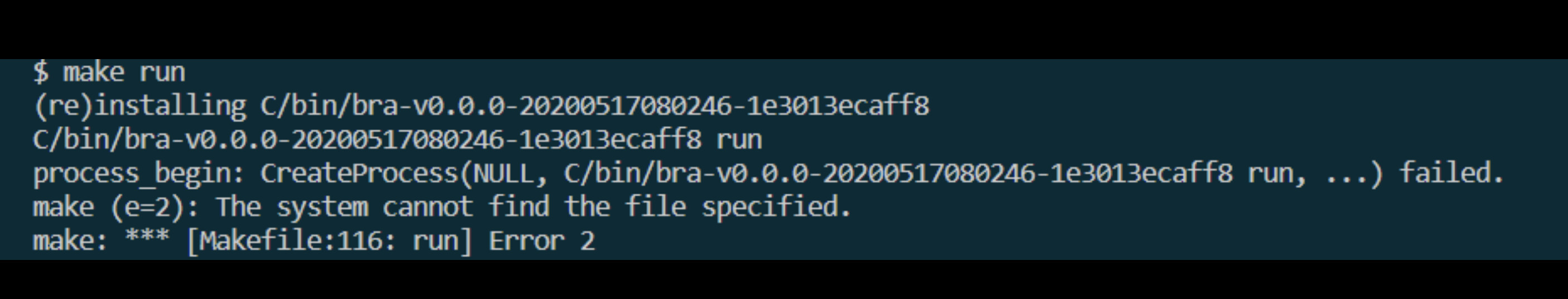

make run > failed
you can check the error msg on the attachment.

I am facing the same issue.
I started the yarn with yarn start.
I built the back-end with wire and
C:\Users\User\go\bin\wire.exe gen -tags oss ./pkg/server ./pkg/cmd/grafana-cli/runner
go run build.go build
I write the command
make run
on git bash, but I get the same error with bra-v0.0.0-20200517080246-1e3013ecaff8
What should I do?
