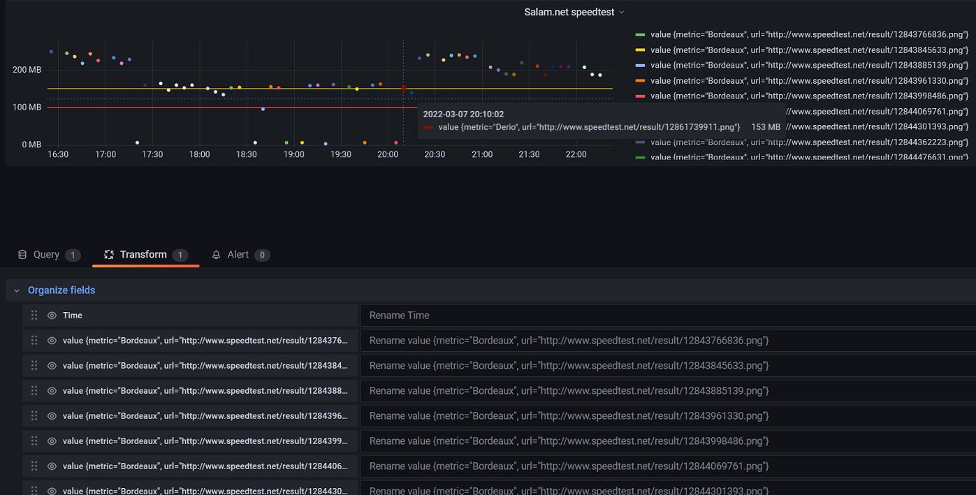

Have you tried using the Organize Fields transformation? This will allow you to hide a field from view:
mattagrams, I am not sure this help in my situation, I need to hide/remove 1field from the legend, not all. Clicking the eye icon next to the field name will hide all the fields

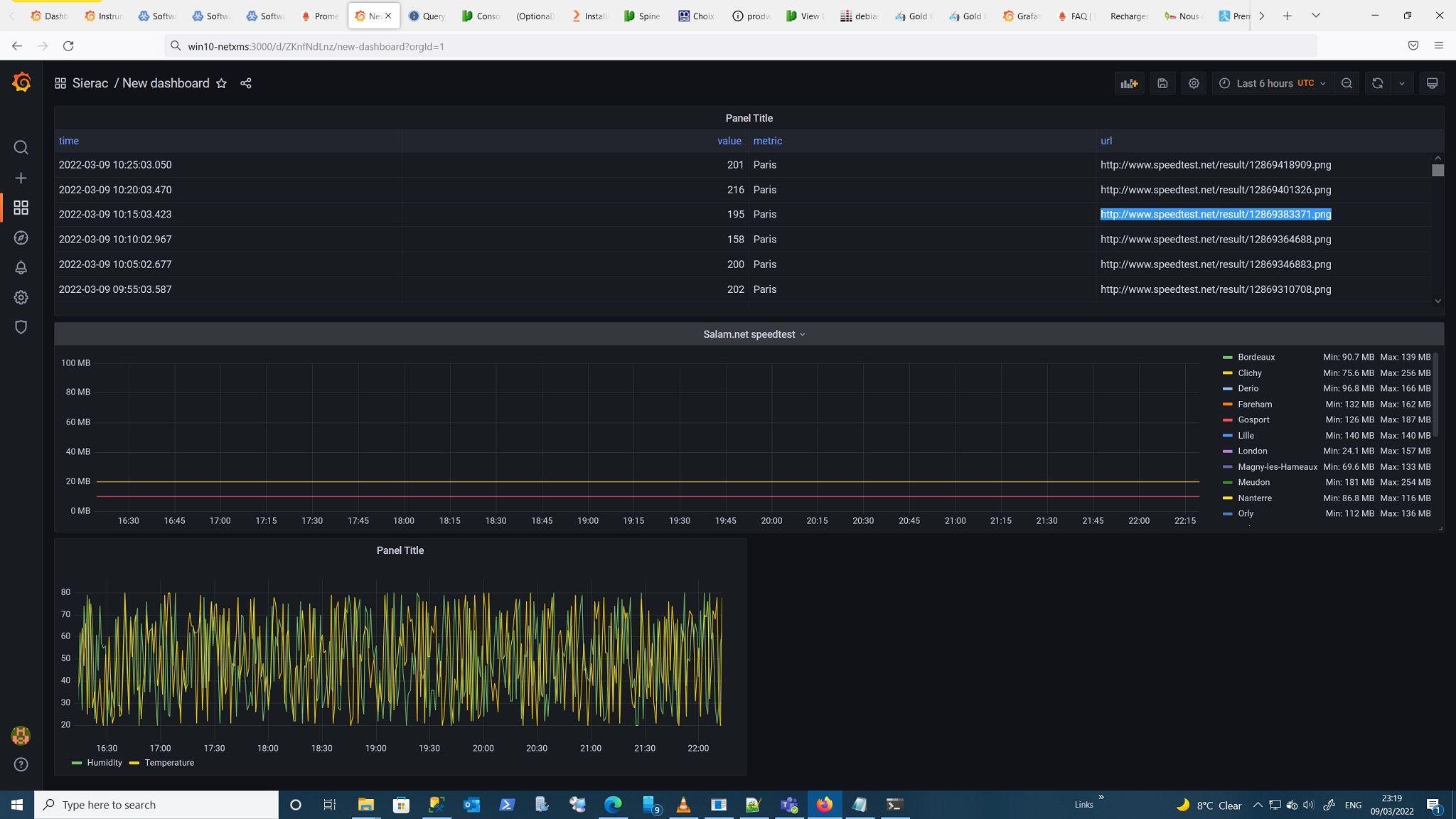

As you can notice in the snapshot, I need to hide the url that appears in the legend
Might be misunderstanding but would not including the URL Field work?

Then having a Table Panel beside it with the same Query as below
SELECT
       [Timestamp]                as time
	  ,(Download / (1024 * 1024)) as value
	  ,City                       as metric
      ,url
FROM [BaselineDB].[dbo].[speedtest]
where url is not null
ORDER BY [Timestamp] DESC
To give you a graph for the download speed grouped by City on the Graph and a URL in the Table

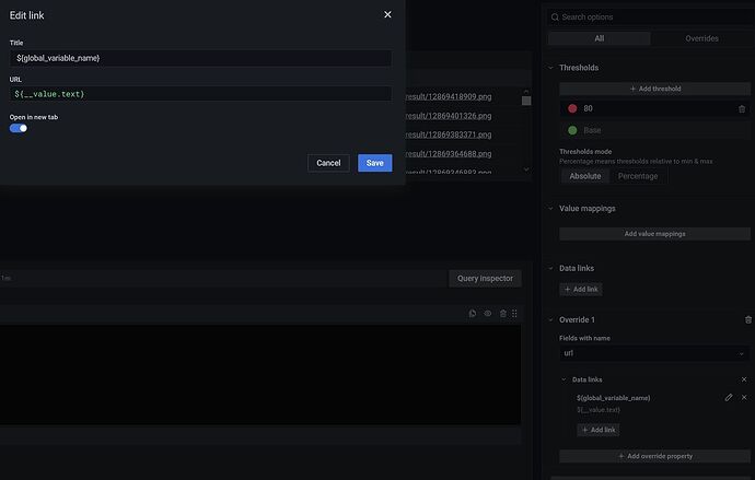

Yes, I get a table, can I make the 3rd filed , the url item in each cell clickable? I would like to click the link so I can see the image
Think this could help hopefully?

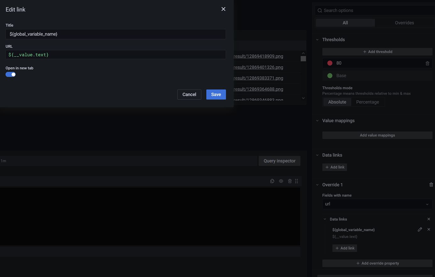

Yes, correct, it helped and now urls are clickable. However, where does the value of
${global_variable_name} come from?
2nd, when I did chose the url field, then added the data link, I had only 2 elements to populate not 3 as indicated in the thread
Think you’d just leave that Title field blank and that should be you done

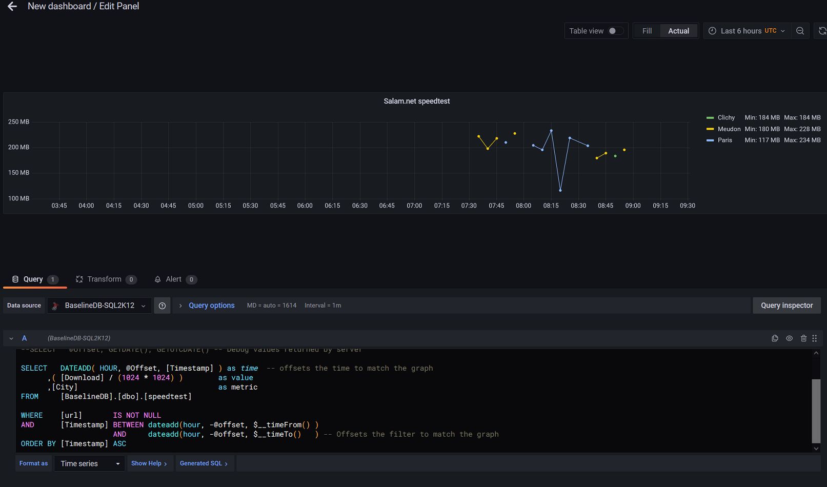

Ok, check that but if not then you’ll have to do this, or debug SQL Server time, or Change the input datatype to DateTimeOffset (datetimeoffset (Transact-SQL) - SQL Server | Microsoft Docs)
DECLARE  @offset int        = datediff( HOUR, GETDATE(), GETUTCDATE() )
--SELECT   @offset, GETDATE(), GETUTCDATE() -- Debug values returned by server
SELECT   DATEADD( HOUR, @Offset, [Timestamp] ) as time  -- offsets the time to match the graph
	    ,( [Download] / (1024 * 1024) )        as value
	    ,[City]                                as metric
WHERE    [url]       IS NOT NULL
AND      [Timestamp] BETWEEN dateadd(hour, -@offset, $__timeFrom() )
                     AND     dateadd(hour, -@offset, $__timeTo()   ) -- Offsets the filter to match the graph
ORDER BY [Timestamp] ASC
I updated the python script to write local time instead of UTC, still grafana displays data 1 hour earlier. I will go through your recommendation and let you know

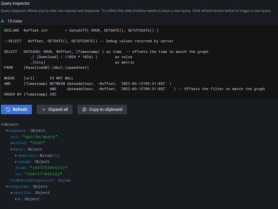

I update the T-SQL as suggested, it is now 10:31 still when I use query inspector, I see
timeto = 9:31 and not 10:31
graph is up to 9:31
whereas in SQL database I have 5 records after 9:31
sql_932
