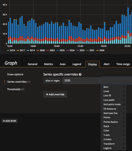

Display - series override option to change legend name
Not sure if there is a way to do this currently with Grafana / Elasticsearch and I am just missing it. The problem I have is a dynamic list of customer_id values like 2035, 4011 being returned by the query which I need to replace with a friendly name like “Customer1”.
Series override is a great option for changing colors, index, etc… but I do not see an option to replace the legend name.
Grafana v4.2.0 (commit: 349f3eb) using Elasticsearch datasource.
