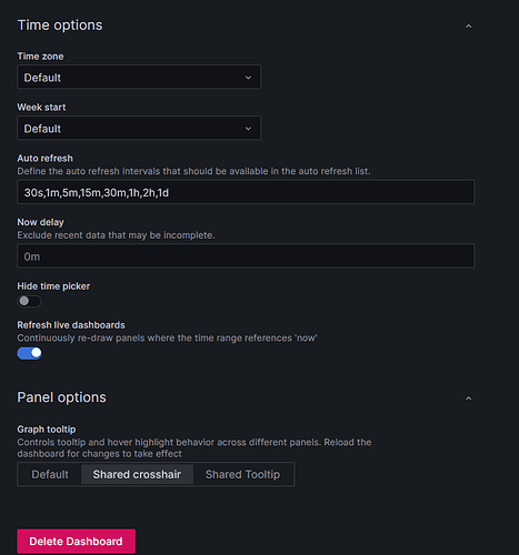

I can see:

After restarting the grafana-server service, I can see the new value on my dashboard settings:

In my case if I configure the .ini with a value, the auto value will be the same (I suppose it takes the min-value):
the ini:
dashboard settings:
dashbord refresh time setting:
Actually your question is really interesting: I don’t see any connection between your 30s and the 5m but I don’t see neither how to change the default value of auto. I’ve read the whole .ini file (with a time filter), and nothing appears to be related to this option… In my case it seams to always take the smallest value.
