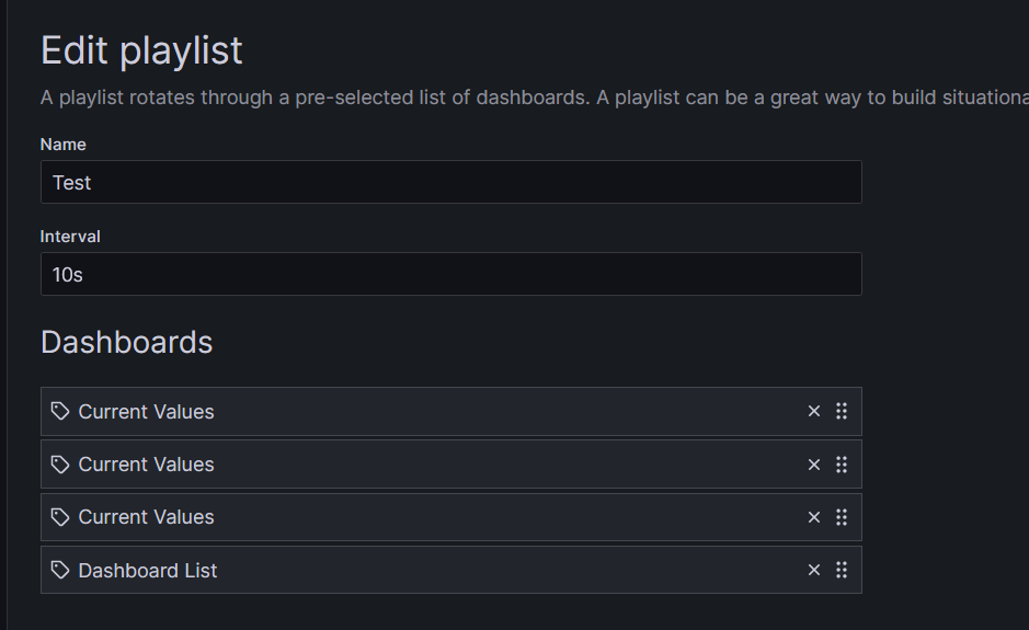

Hi,
That’s Great thanks. But is there any way of using different timings per page?
Each dashboard is displayed for the amount of time entered in the Interval field, but you can add the same dashboard as many times as you need:
