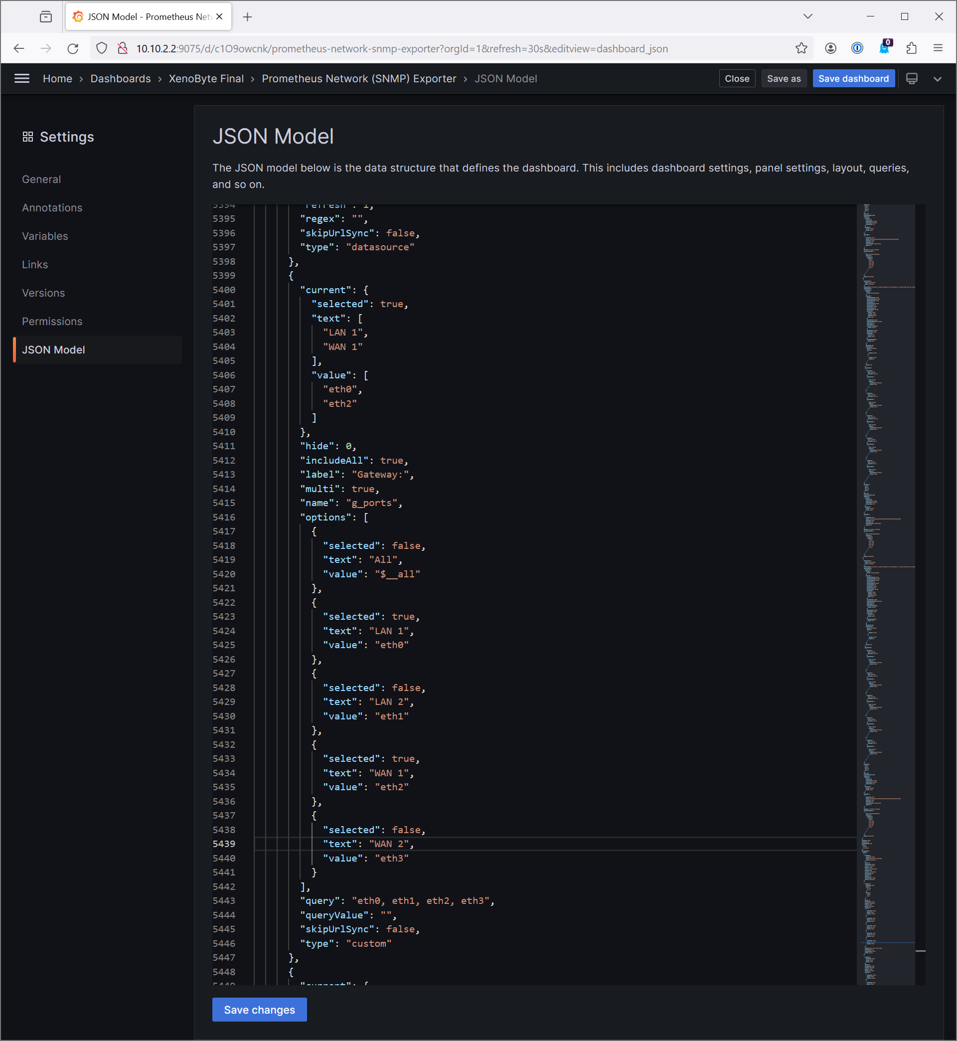

I would like to change displayed variable names on a Dashboard. Here are the variables:
And here they are shown as filters on the Dashboard:
I want to display the ports and radios with the following names:
  • eth0 → LAN 1
  • eth1 → LAN 2
  • eth2 → WAN 1
  • eth3 → WAN 2
  • rai0 → Niartherum Home AP
  • rai2 → Niartherum Guest AP
How are you trying to achieve it?
I then go to the JSON Model, and try to change the display names (the “text” fields), as follows:
Before change:
After change:
What happened?
When I click “Save change”, NOTHING happens - it switches back to this:
And this:
What did you expect to happen?
I would expect that changing the text values actually worked, that you could save it, and it would change the display names on the Dashboard. This has worked on previous versions of Grafana.
