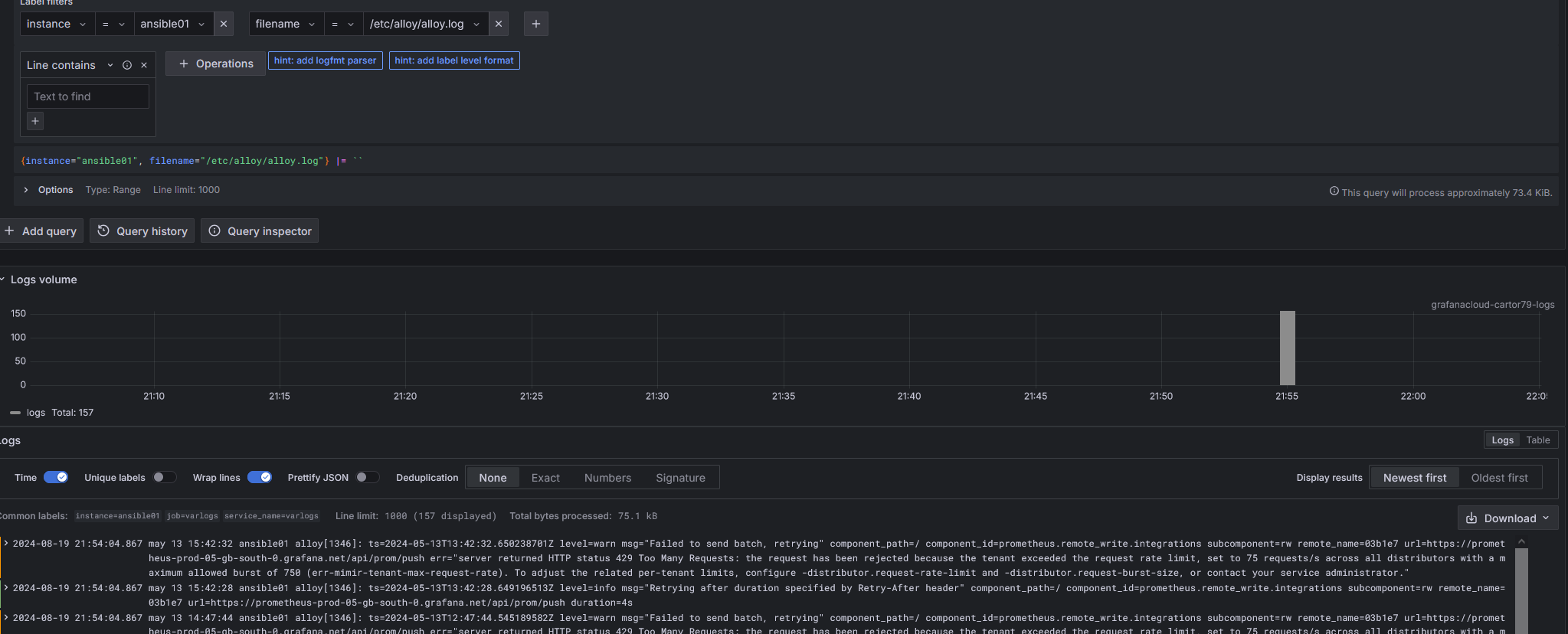

I didn’t know of the existence of that IA, really useful.I took a look to see that everything looked well. Which made me think that maybe the problem was the log in the second pipeline.
You asked me how often the log in the second pipeline was changing, and true is :smile: that it only changed when I added info on it manually. That question you made make me think that maybe that was the problem.
I tried this, instead of pointing to /log/mylog, I pointed to /etc/alloy/alloy.log (I guess this is a bad practice, but for testing purposes did the trick), and it worked xD

Now, I can see in grafana that the log in the second pipeline has being collected
