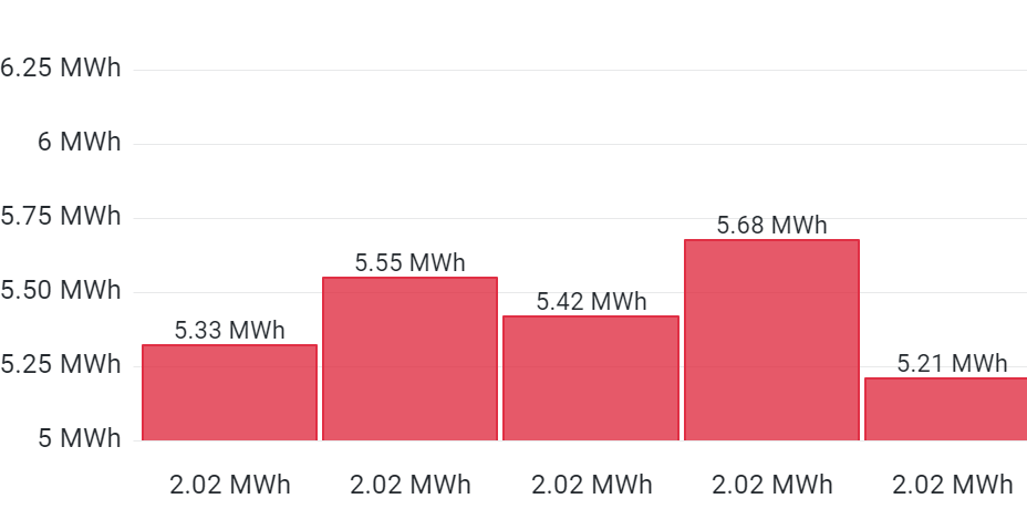

To have the x-axis in a bar-chart as normal strings. They are in the table as string but are displayed in the units in the chart
Now I of course would like to have the year displayed as normal string in the graph as well.

I also played around with the “Convert field type” transformation. As soon as I do anything there, it shows the correct strings:
[Cannot upload another picture as I’m a new user…]
I can then save it but as soon as I exit to the dashboard view it has again the units attached.

Grafana converts those year strings to a number and attaches the unit.
Anyone any idea how I can achieve this?
