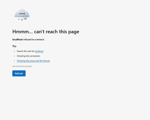

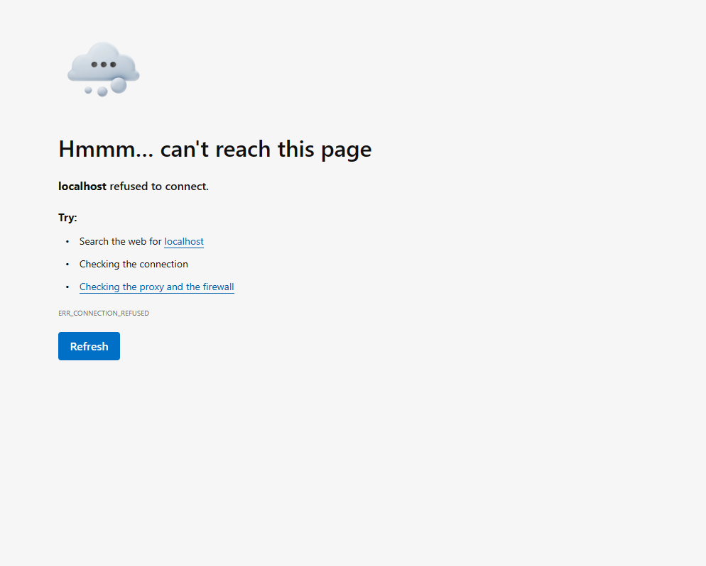

We want to login with https://grafana-staging.domain/login/azuread but we are still getting this error -
AADSTS50011: The redirect URI ‘http://localhost:3000/login/azuread’ specified in the request does not match the redirect URIs configured for the application ‘2c213ae5-9e81-49bb-839c-3f7d3aee2395’.
We are not sure what change should we need to make in Grafana config so that it redirects us to the Azure redirect uri mentioned above
