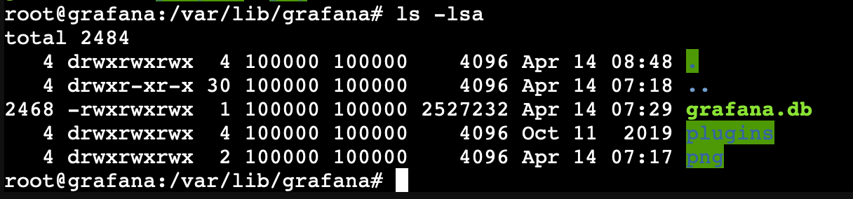

For testing, I set the permissions to 777 but the error persists:
![pve_-_Proxmox_Virtual_Environment-3|565x500](upload://oT
8IG92uwSqEL6abjqAbNaSa2tq.png)
I do not understand, why this persists, even with 777 permissions
In theory this is not needed, but I had to change the permissions of everyone to write (yes, all)
chmod -R a+w /var/lib/grafana
This sounds to me more like an ownership problem than a permissions problem.
You’ve said you’ve tried changing the permissions to 777 on everything (which
I do NOT ever recommend as even a medium-term solution - try it by all means
as a debugging tool to see if it makes the error go away, but then find the
proper solution and use that instead).
However, what are the ownerships on your files in and under /var/lib/grafana?
Is it possible that you’ve copied them (you don’t say how this was done) in
such a way that either:
a) the old ownership was preserved and that user or ID no longer exists on the
new machine
b) the files got copied as root and now have an ownership which Grafana can’t
work with
c) Ubuntu 19.10 runs Grafana differently from whatever it was you upgraded from
Antony.
It is probably an ownership problem. In my case, despite I was specifying the proper USER id and GROUP id to the docker image and the volume mounted into it had the proper ownership wit the IDs I specified to the docker image. However it didn’t worked until:
  • I used the group id and user id the container uses instead the ones I was specifying to it
  • I added write permissions to all recursively on the mounted volume
level=error msg=“Exec failed” error=“attempt to write a readonly database” sql=“CREATE TABLE IF NOT EXISTS migration_log (\nid INTEGER PRIMARY KEY AUTOINCREMENT NOT NULL\n, migration_id TEXT NOT NULL\n, sql TEXT NOT NULL\n, success INTEGER NOT NULL\n, error TEXT NOT NULL\n, timestamp DATETIME NOT NULL\n);”
Error: âś— migration failed (id = create migration_log table): no such table: migration_log
I have given the access 0777 but it is giving me the above error
