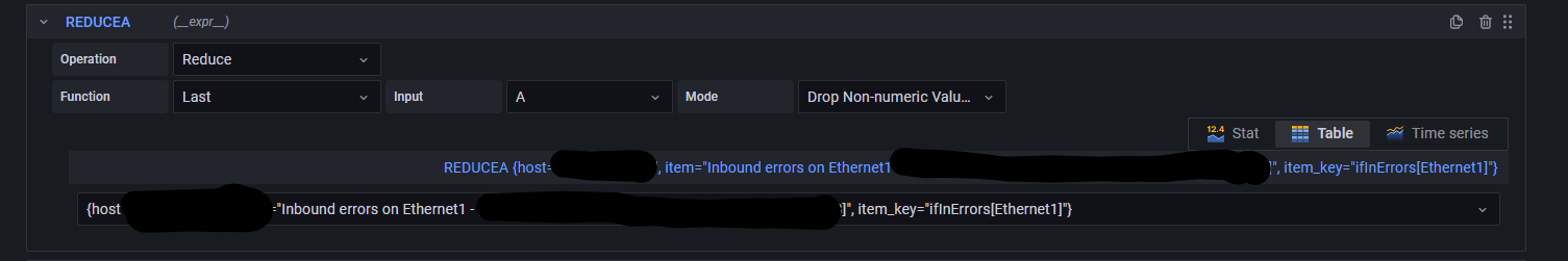

The I reduce each time series (Like A → REDUCEA):

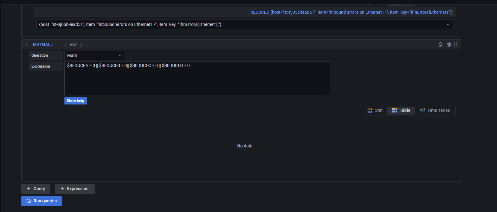

And then I do math with all the reduced series (Because I do want to be able to extract the labels):

Everything you showed and explained looks fine to me.
Are you alerting off the correct expression? (MATHALL?)
Apologies, missed that. Yep, looks like it is the case:
Which version of Grafana are you using? I am using v9.2 OSS. I noticed my screenshot says “Set Alert Condition”, while yours says “Define Alert Condition” and you do not have a radio button like I do.
Mine is 8.5.4. Maybe is time to upgrade.
